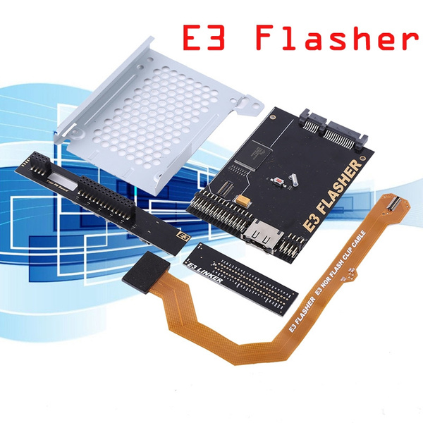

0 1 0 0 0 0 0 0 Failed to initialize TF card SD card not seated properly / Can't open bkpps3.bin
0 1 0 0 0 1 0 0 Failed to read files in TF card SD card not seated properly / Can't find bkpps3.bin (Check its file name)
0 1 0 0 1 0 0 0 Failed to open TF card SD card not seated properly / Can't find bkpps3.bin (Check its file name), or... cannot find e3_downgrade.bin (Flip switch #6 'Lock / Unlock')
0 1 0 0 1 1 0 0 Failed to write files to TF card SD card not seated properly
1 0 0 0 0 1 0 0 Failed to initialize NOR in E3 Check E3 Linker Pads / Reattach ribbon on E3 - It is not on properly.
1 0 0 0 0 1 0 1 Failed to read NOR in E3 Check E3 Linker Pads / Reattach ribbon on E3 - It is not on properly.
1 0 0 0 0 1 1 0 Failed to erase NOR in E3 Check E3 Linker Pads / Reattach ribbon on E3 - It is not on properly.
1 0 0 0 0 1 1 1 Failed to write NOR in E3 Check E3 Linker Pads / Reattach ribbon on E3 - It is not on properly.
1 0 0 0 1 1 0 0 Failed to initialize PS3 BIOS Check E3 Linker Pads / Reattach or apply pressure to clip on PS3 / Reattach ribbon on E3 - It is not on properly.
1 0 0 0 1 1 0 1 Failed to read PS3 BIOS Check E3 Linker Pads / Reattach or apply pressure to clip on PS3 - It is not on properly.
1 0 0 0 1 1 1 0 Failed to erase PS3 BIOS Check E3 Linker Pads / Reattach or apply pressure to clip on PS3 - It is not on properly.
1 0 0 0 1 1 1 1 Failed to write/erase PS3 BIOS Check E3 Linker Pads / Reattach or apply pressure to clip on PS3 - It is not on properly.
1 1 0 0 0 0 0 0 Wrong settings of switches Check toggle switch - wrong setting
1 1 0 0 0 0 1 0 PS3 is operating NOR, E3 Flasher cannot operate at the same time Check toggle switch - wrong setting / Reattach ribbon on E3
1 1 0 0 0 1 0 0 Not the right PS3 for this backup Already used e3flasher on 1 console
1 1 0 0 1 0 0 0 Wrong PS3 version, not supported at present Metldr.2 model undowngradable
1 1 0 0 1 1 0 0 Wrong function settings Check toggle switch - wrong setting
1 1 0 0 1 1 1 1 Missing Tristate Check SBE (Tristate) connection on ribbon
